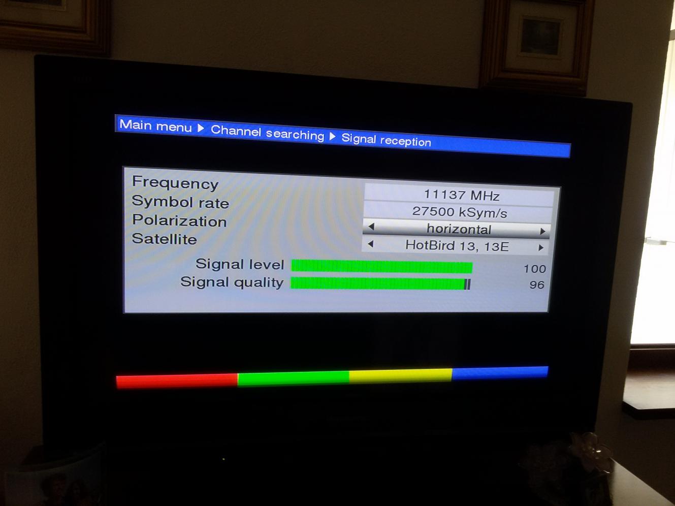

After trying another decoder to be sure that both astra and hotbird are working, i did a factory reset on my technisat and left it search for hours, situation got better: all channels were working.
From this week, i'm still facing problems. Now, most of channels aren't working: France3, Canal+ hd, tmc, nrj12,iTele,d17,cherie 25, canal + cinema hd, tv5 monde europe, tv5 monde fbs. When i turn on decoder, i don't get any message or warning.

  • Both astra and hotbird signals are strong.

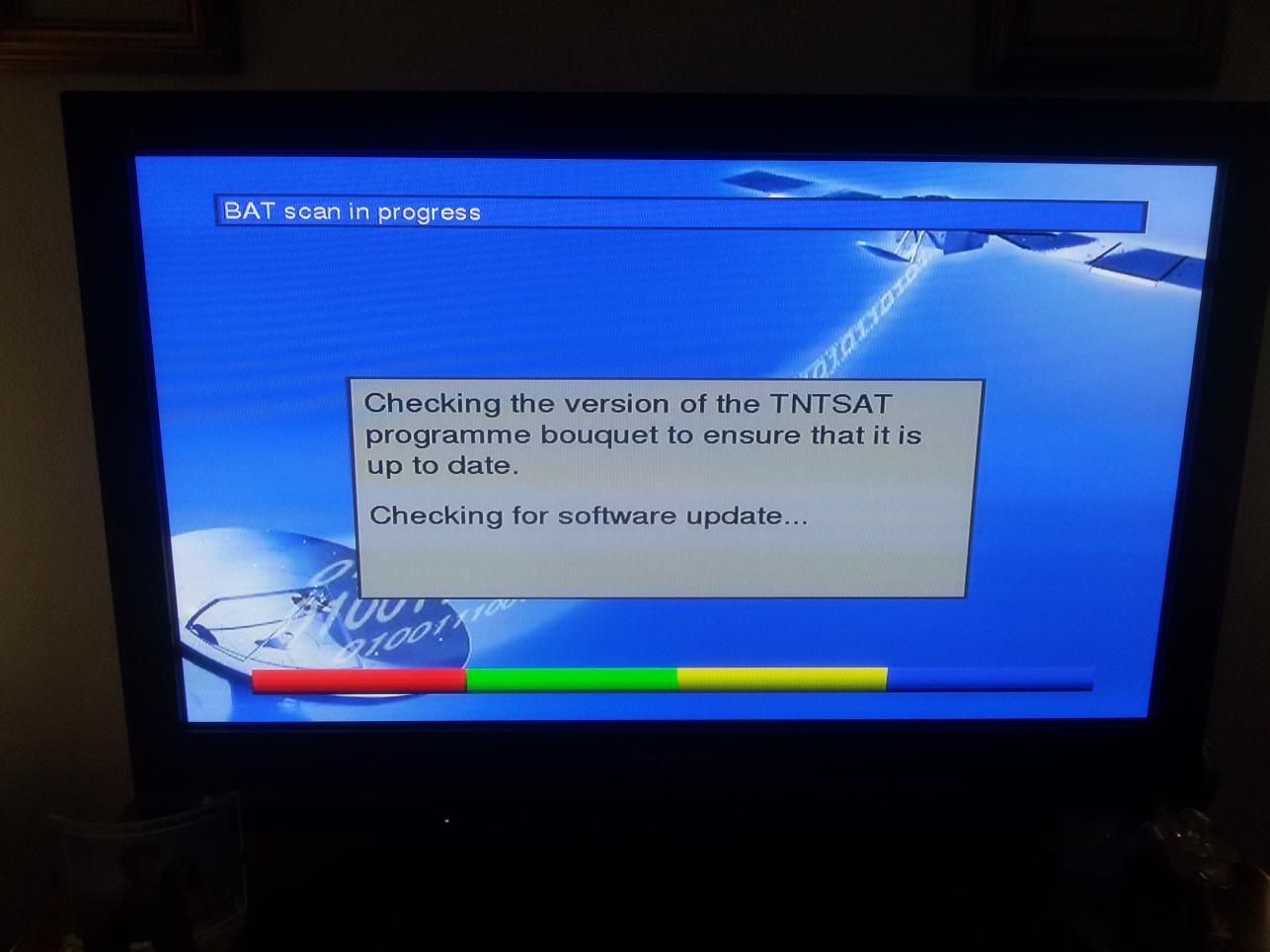

A ce propos une mise a jour est prévue pour le technisate technibox HD VA les lundis et mardi des semaines impaires
Ne ratez pas la prochaine ...

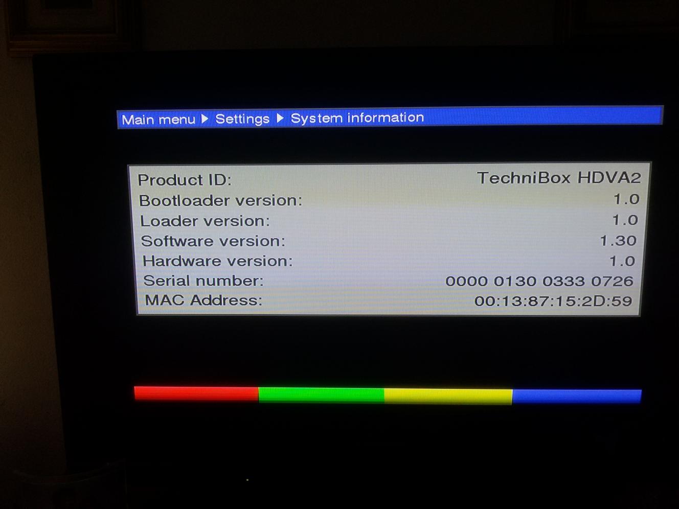

Perfect, but i can't find how to update my decoder. I can't find it in menu, and on the web i can't find firmware how-to
upgrade for my decoder. Neither on technisat website. (I find TechniBox HD VAC but it's not the same..)
Do i have only to leave it turned on and he will do a silent upgrade?
Because when i turn it on, i see that it searches something, but then it goes on normal without any message.
Now i try leave it turned on for all night and tomorrow i will see.
Then, i will leave it turned on also on Mondays and Tuesdays over odd weeks.
Now i just have an idea... maybe i must search all Astra channels, then search a channel used for firmware upgrades and leave it for a moment.. Am i wrong?

Good afternoon,
Yes, my parabole is well configured because i can see all Astra channels (now I found how to scan all channels, and not only TNTSAT). I tried also with a normal decoder (no TNTSAT) and Astra is working well.
matousurnet and BAISIN found the root of my problem: my decoder isn't updated or it doesn't take updates from TNTSAT, so now I'm working to find how to do it. I cross fingers for tomorrow and after tomorrow to see if it updates (odd week updates).

Yes, I did a mistake looking at calendar.... I have to wait 2 weeks.
Btw here i found an interesting article http://campingcarvdl.canalblog.com/archives/2014/11/10/30927499.html
I tried to connect decoder to my LAN but still nothing... I can't understand... I already have the firmware version 1.30.
And also, they write it's enough to restart my decoder and it will see new firmware or news from TNTSAT. Why did it never update frequencies from december ? Almost everyweek we turn it on... but i'm not sure my mother uses it on monday and tuesday...

AttachmentAttachment
Édité par lethal.industry le 21/06/2015 à 15:41:14

M marceljack
lethal.industry a écrit thank you for the info... Yes my card is valid till 2018. I have problems only with some channels (Eg TMC).
I hope tomorrow it will take new updates. I will do an individual scan.
But my doubt is: how decoder will know new frequences?
TNTSAT receivers automatically search for channel and software updates at power-up and if your dish is correctly aimed at Astra1, it will store the new frequency plan.
However from the discussion above I have some doubts about the correct adjustment of your antenna.

Hm, that's a good tip thanks, but, for example, in the image attached there is the signal level of TV5 Monde FBS and it's very strong, but I can't see it (always same message to contact my installer....)
Hm , par exemple , dans l'image jointe il ya le niveau de TV5 Monde FBS de signal et il est très fort, mais je ne peux pas le voir (toujours même message à communiquer avec mon installateur .... )
P Philtranfaye
http://fr.kingofsat.net/tp.php?tp=246
il devrait s'agir de TV5 monde Europe, et non pas TV5 monde FBS, sur le 13°
Cela fonctionne, avez vous essayé avec un récepteur dont vous êtes sûr ?

M marceljack
If you receive Hotbird, it means that you have either a monoblock LNB or two LNBs and a DiSEqC switch.
Most TNTSAT receivers only work correctly if Astra is in DiSEqC position 1, (which is not the case with most monoblocks).
If Astra is not in position 1, automatic channel list and software updates can be missed because the receiver is looking for these updates on DiSEqC position 1, even if Astra has been configured on position 2 at initial setup.
This is a bug common to many TNTSAT receivers.
